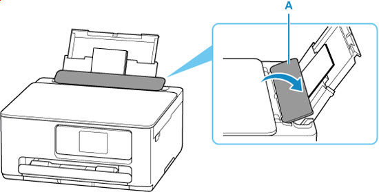

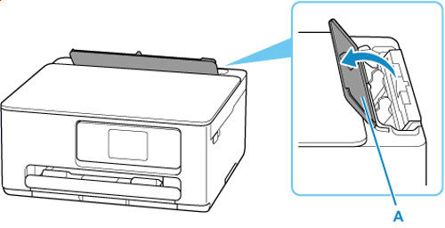

  2. Open the feed slot cover (A).

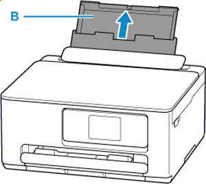

  3. Pull straight up and fold back the paper support (B).

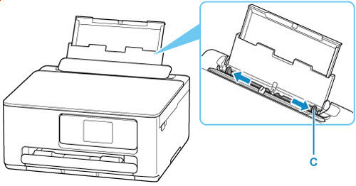

  4. Slide the right paper guide (C) to open both paper guides.

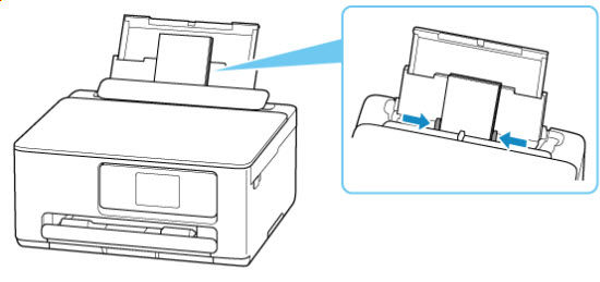

  6. Move the right paper guide and adjust the guides to both edges of the envelopes.
    Don't slide the paper guides too tightly against the envelopes. The envelopes may not be fed properly.
    Slide the right paper guide to align the guides with the sides of the envelopes

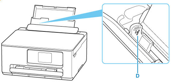

     Don't load envelopes higher than the load limit mark (D).

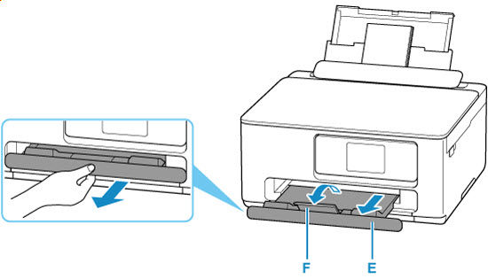

  9. Pull out the paper output tray (E) and open the paper output support (F).
    Pull out the paper output tray (F) and open the paper output support (G)
 To prevent incorrect printing, this printer has a function that detects whether the settings for the paper loaded on the rear tray matches the paper settings. Before printing, make print settings in accordance with the paper settings. When this function is enabled, an error message is displayed if these settings do not match to prevent incorrect printing. When this error message is displayed, check and correct the paper settings.
