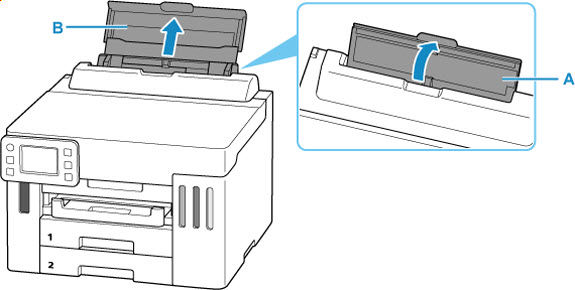

  2. Open the rear tray cover (A) and then pull up the paper support (B).

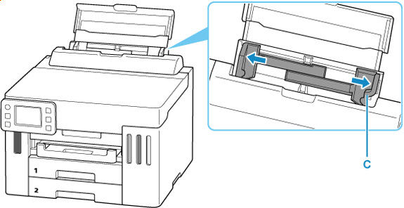

  3. Slide the right paper guide (C) to open both paper guides.

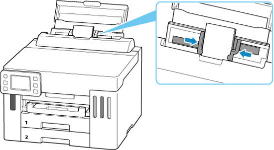

  1. Slide the right paper guide to align with both sides of the envelopes.
    Don't slide the paper guides too hard against the envelopes. The envelopes may not be fed properly.

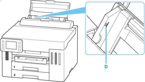

     Don't load envelopes higher than the load limit mark (D).

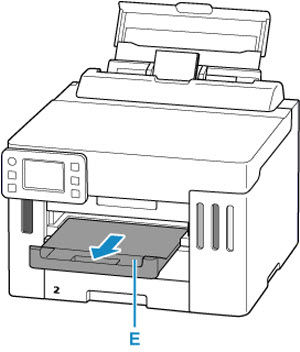

  3. Pull out the paper output tray (E).
