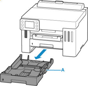

  2. Pull out the cassette (A) from the printer.

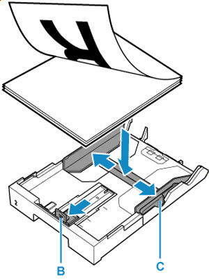

  3. Slide the paper guides (B) in front and (C) on the right to open the guides.
  4. Load the paper stack in portrait orientation WITH THE PRINT SIDE FACING DOWN, and place it in center of the cassette.
    Load the paper face down
     Always load paper in portrait orientation (D). Loading paper in landscape orientation (E) can cause paper jams.

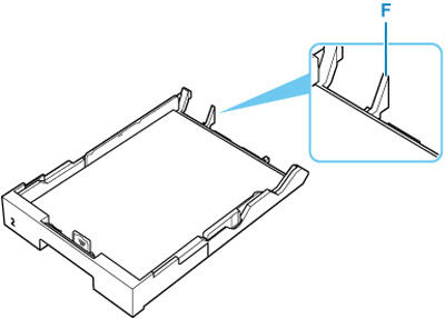

     Align the paper stack with the edge of the cassette as shown in the figure below.
    If the paper stack is in contact with the protrusion (F), the paper may not be fed properly.

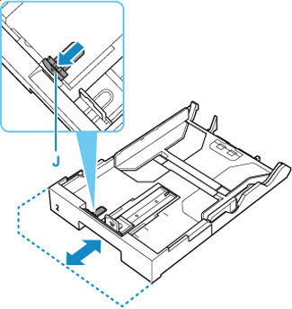

     To load Legal-sized paper in Cassette 2, pull the resizing tab (J) forward to extend the cassette.
     To load paper sizes other than Legal, use the cassette in its condensed state. To condense the cassette, pull the resizing tab (J) forward.
    Pull the resizing tab (J) forward to extend the cassette

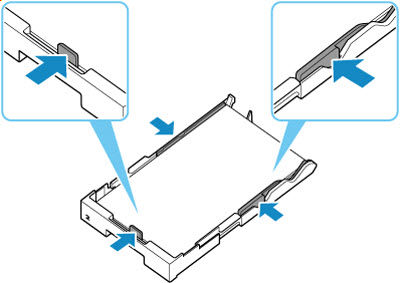

  5. Slide the paper guides to align them with the paper stack.
    Don't slide the paper guides too hard against the paper. The paper may not be fed properly.
    Slide the right paper guide to align it with the paper stack

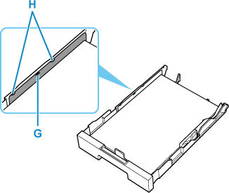

     Don't load sheets of paper higher than the load limit mark (G).
     Keep the paper stack height below the tabs (H) of the paper guides.

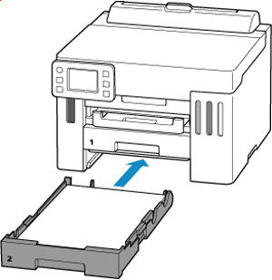

  6. Insert the cassette into the printer. Push the cassette until it stops.
    Mount the cassette cover and insert the cassette into printer

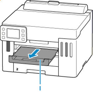

  8. Pull out the paper output tray (I).
