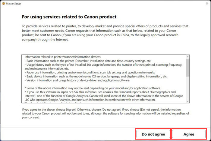

  4. When asked about data sharing, click Agree or Do Not Agree.
    Click Agree or Do not agree (both outlined in red) to proceed

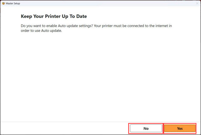

  8. When prompted, choose Yes or No to keep the printer’s firmware up to date.
    Select Yes or No (outlined in red)

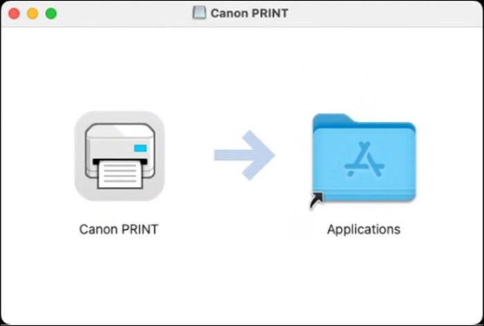

Get Canon PRINT here. After downloading the file, drag Canon PRINT to the Applications folder.
Drag Canon PRINT to the Applications folder
