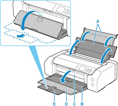

  2. Open the paper support (A) of the top feed.
  3. Gently open the paper output tray (B).
     If the multi-purpose tray guide (C) is open, be sure to close it.
  4. Open the output tray extension (D), then pull out the paper output support (E).
    Figure: Open the output tray extension (D), then pull out the paper support (E)

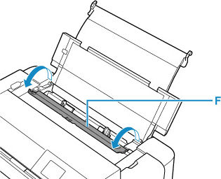

  5. Open the feed slot cover (F).
    Figure: Open the feed slot cover (F)

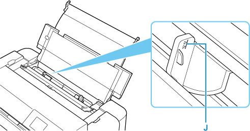

     Do not load sheets of paper higher than the load limit mark (J).
    Figure: Don't load sheets of paper higher than the load limit mark (J). Doing this may cause problems with paper feeding
