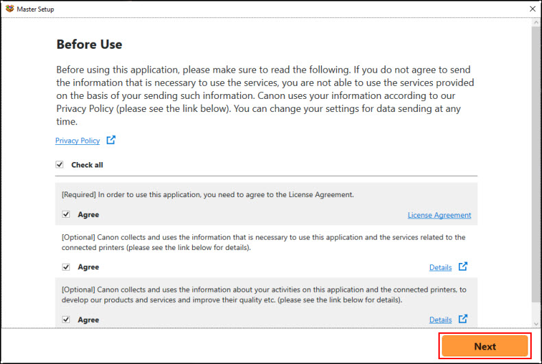

  4. In order to proceed, you must agree to the License Agreement. Click License Agreement to read it, then place a check in the box next to Agree. You may also choose to agree to requests for information from Canon by placing a check in the appropriate boxes. Click Next to proceed.
    Click Next (outlined in red) to proceed

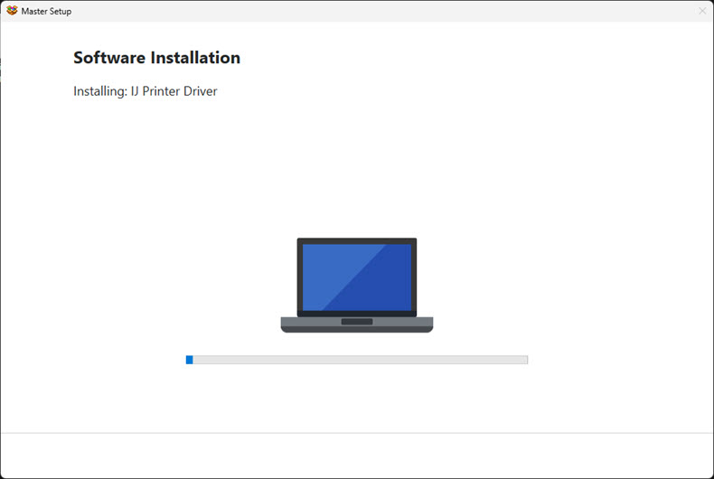

    The printer driver will be installed. Please wait.
    Installing the printer driver

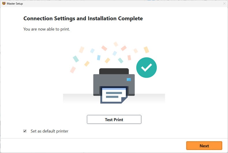

  10. After processing for a few moments, the following screen will appear. Select Next.
     If desired, select Test Print to print a test page.
    If you want to use the printer as the default printer on the computer, leave the Set as default printer box checked. If you want to use a different printer as the default printer, remove the check from this box.
