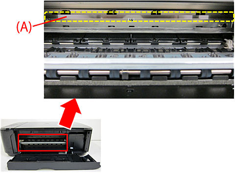

  3. Open the paper output cover.
    Paper output cover shown being opened
  4. Check the encoder film (A) inside the printer.
    Encoder film (A) shown inside the printer

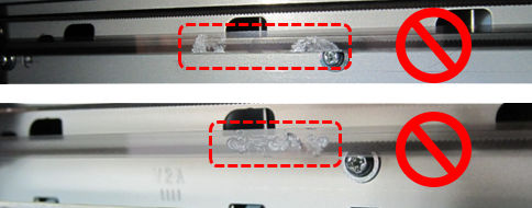

    If the film is smeared as shown below, you will need to clean it.

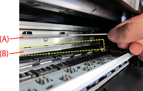

Clean the encoder film
  1. Moisten a cotton swab with the isopropyl alcohol or window cleaner.
    Caution Don't use any other detergents. Squeeze any extra liquid from the cotton swab.
  2. Gently move the cotton swab over the surface of the film, until the entire film is transparent and clear. Don't push on the film.
    Caution Be careful not to let liquid drop inside the printer.
    Caution Clean only the encoder film (A), not the rail (B). If you clean the rail, the print quality may decrease.
    Caution Keep your hands off the printer as shown below, and change the cotton swab often as you clean.
    Encoder film (A) and rail (B) shown. Image shows person cleaning A with a cotton swab, without touching the inner parts with is hand.
