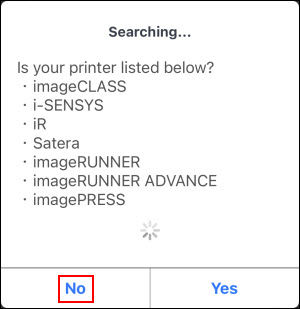

  9. When the following message appears, tap No, or wait for a few moments.
    Tap No (outlined in red)
