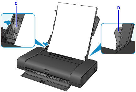

  4. Slide the paper guide (C) to the left, and load the paper against the far right (D) of the rear tray WITH THE PRINT SIDE FACING YOU.
  5. Slide the paper guide (C) to align it with the paper stack.
    Do not slide the paper guide too hard against the paper. The paper may not be fed properly.

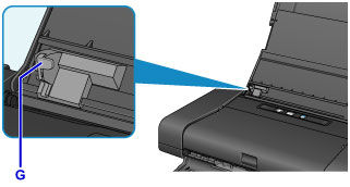

    • Keep the paper stack height below the tab (G) of the paper guide.

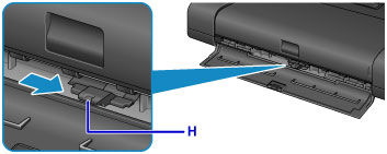

  6. Set the paper thickness lever (H) to the right.
     Note
    • If the corners or edges of the paper are smudged, try to print with the paper thickness lever set to the left. It may improve print quality. Reset the paper thickness lever to the right when you finish printing.
