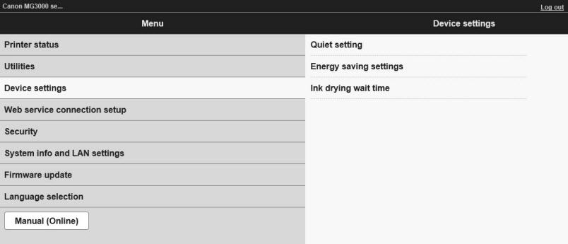

Device settings
In this section, you can make adjustments for the Quiet setting, Energy saving settings and Ink drying wait time.
For the Quiet setting, you can specify if you want to use the quiet mode or not. Click on the option you prefer and then click OK. Click the back arrow
to go back to the Device settings menu.
The Energy saving settings and Ink drying wait time sections will operate in a similar fashion.
