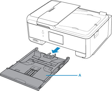

  2. Pull out the cassette (A) from the printer.

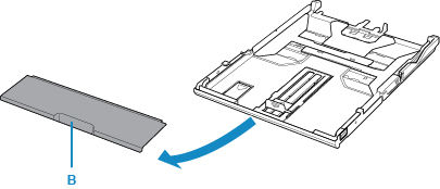

  3. Remove the cassette cover (B).

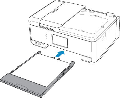

  9. Mount the cassette cover, and then insert the cassette into the printer.
    Push the cassette into the printer until it stops.

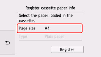

    After inserting the cassette into the printer, the paper information registration screen for the cassette is displayed on the touch screen.
  10. Select the size and type of the loaded paper in the cassette at Page size, then select Register.

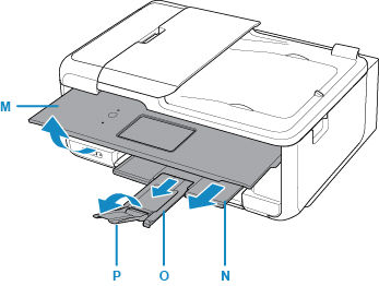

  11. Open the operation panel (M), pull out the paper output tray (N) and paper output support (O), and open the output tray extension (P).
    Be sure to open the operation panel before printing. If the operation panel is close, the printer does not start printing.
