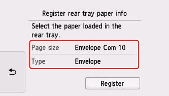

The paper registration screen displays. Select the envelope size (Page size) and Type, then select Register.
