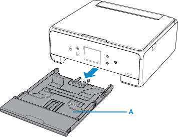

  2. Pull out the cassette (A) from the printer.

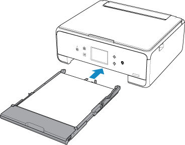

  8. Mount the cassette cover, and then insert the cassette into the printer.
    Push the cassette into the printer until it stops.

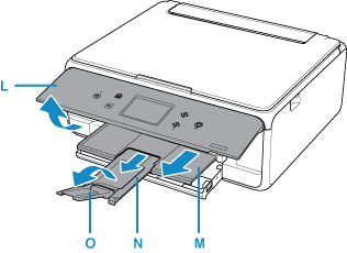

  10. Open the operation panel (L), pull out the paper output tray (M) and paper output support (N), and open the output tray extension (O).
    Be sure to open the operation panel before printing. If the operation panel is close, the printerdoes not start printing.
