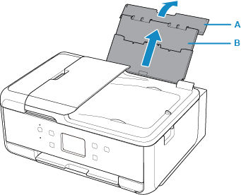

    1. Open the rear tray cover (A) and then pull up the paper support (B).

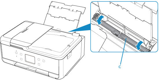

    2. Open the feed slot cover (C).

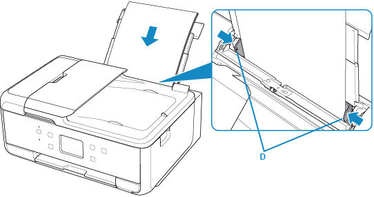

    3. Slide the paper guides to open them, and load the paper in the center of the rear tray WITH THE PRINT SIDE FACING UP.
    4. Slide the paper guides (D) to align them with both sides of the paper stack.
      Do not slide the paper guides too hard against the paper. The paper may not be fed properly.
       Important
      • Always load paper in the portrait orientation (E). Loading paper in the landscape orientation (F) can cause paper jams.
       Note
      • Do not load sheets of paper higher than the load limit mark (G).

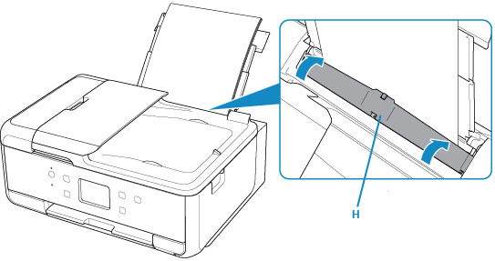

    5. Close the feed slot cover (H) gently.
       Important
      • If the feed slot cover is open, paper cannot be fed. Be sure to close the feed slot cover.
      After closing the feed slot cover, the paper information registration screen for the rear tray is displayed on the touch screen.
    6. Select the size and type of the loaded paper in the rear tray at Page size and Type, and then select Register.

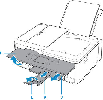

    7. Open the operation panel (I), pull out the paper output tray (J) and paper output support (K), and open the output tray extension (L).
      Be sure to open the operation panel before printing. If the operation panel is close, the printer does not start printing.
