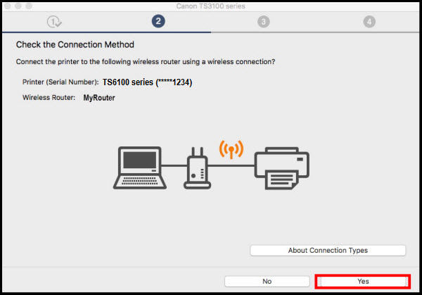

  7. Select Yes on the Connection Method screen.
    Yes button on Connection Method screen
