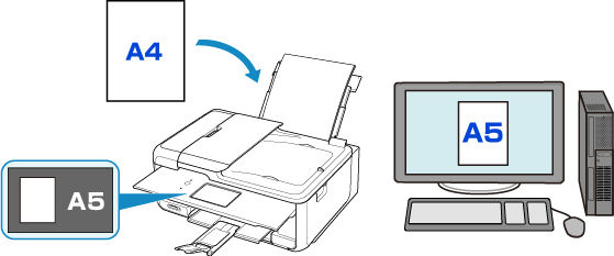

When the paper settings for printing or copying are different from the paper information registered to the printer:
Ex:
When you start printing or copying, a message is displayed.
Selecting OK on the touch screen displays the paper setting specified for printing or copying under the message.
Check the message and select OK. When the screen to select the operation is displayed, select one of the operations below.
Depending on the setting, the choices below may not be displayed.
Print with the loaded paper.
Select if you want to print on the paper loaded without changing the paper settings.
For example, when the paper setting for printing or copying is A5 and the paper information registered to the printer is A4, the printer starts printing or copying with A5 on the paper loaded.
Replace the paper and print
Select if you want to print after replacing the paper of the rear tray or the cassette.
For example, when the paper setting for printing or copying is A5 and the paper information registered to the printer is A4, you load A5 sized paper before you start printing or copying.
The paper information registration screen is displayed after replacing the paper and closing the feed slot cover or inserting the cassette. Register the paper information according to the paper that you loaded.
If you do not know what paper information to register to the printer, press the Back
button when the screen to select the operation is displayed. When the previous screen is displayed, check the paper size and the media type and register them to the printer.
Cancel
Cancels printing.
Select when you change the paper settings specified for printing or copying. Change the paper settings and try printing again.
