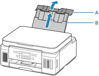

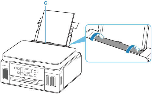

  2. Open rear tray cover (A). Pull straight up and fold back paper support (B).

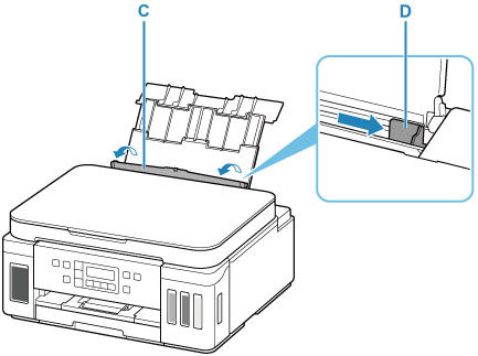

  3. Open the feed slot cover (C).

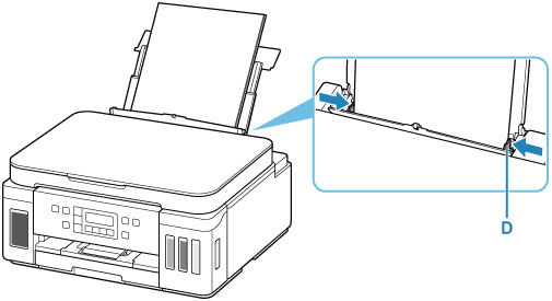

  4. Slide right paper guide (D) to open both paper guides.

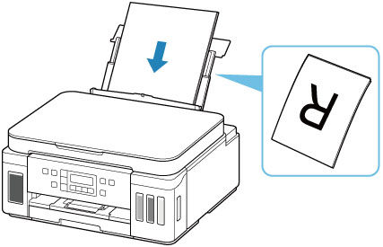

  5. Load paper stack in portrait orientation WITH PRINT SIDE FACING UP.
  6. Slide right paper guide (D) to align with both sides of paper stack.
    Do not slide the paper guides too hard against the paper. The paper may not be fed properly.
    Important

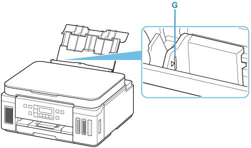

    • Always load paper in portrait orientation (E). Loading paper in landscape orientation (F) can cause paper jams.
    Note
    • Do not load sheets of paper higher than the load limit mark (G).
  7. Close feed slot cover (C) gently.
    Important
    • If the feed slot cover is open, paper cannot be fed. Be sure to close the feed slot cover.

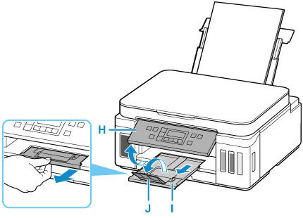

  11. Open operation panel (H), pull out paper output tray (I), and then open output tray extension (J).
    Be sure to open the operation panel before printing. If the operation panel is closed, the printer does not start printing.
