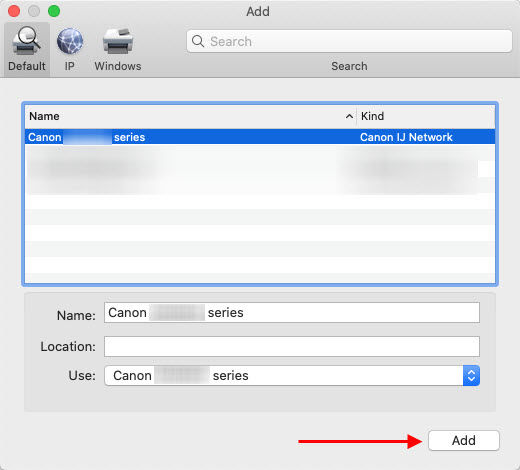

After the drivers are installed, click the Apple menu at the upper left corner of the screen, then click Print & Fax / Print & Scan / Printers & Scanners (the name will depend on which version of macOS you are running).
Click the plus symbol towards the lower left to open the Add window.
When the Add window opens, wait for a few moments. A listing for Canon MG6600 series will appear. Under Kind, you will see Canon IJ Network. Click this listing. After a few moments, make sure that the Use pop-up menu towards the bottom of the window says Canon MG6600 series.
Click Add.
After a few moments, your printer will be added to the printer list.
