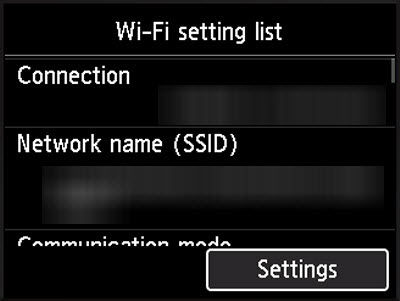

  3. Select Settings and press the OK button.
    Press the OK button

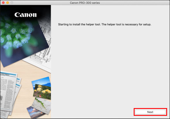

Open the downloaded .dmg file, then double-click the  Setup icon Setup icon.
  1. Click Next
    Click Next (outlined in red)

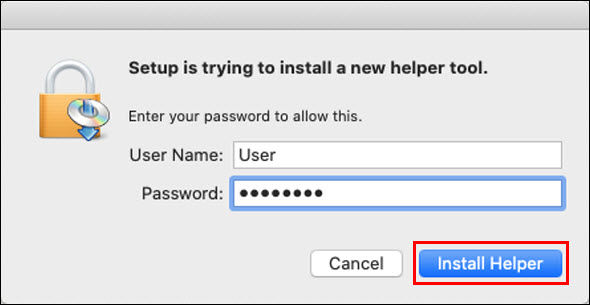

  2. Enter your computer's password and click Install Helper.
    Enter your computer's password, then click Install Helper (outlined in red)

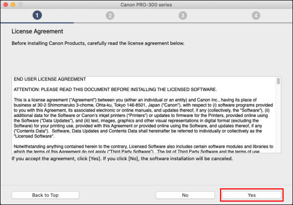

  5. Click Yes on the License Agreement.
    Click Yes (outlined in red) to proceed

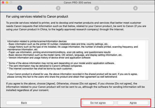

  6. Select Do not agree or Agree.
    Click Agree or Do Not Agree (outlined in red)

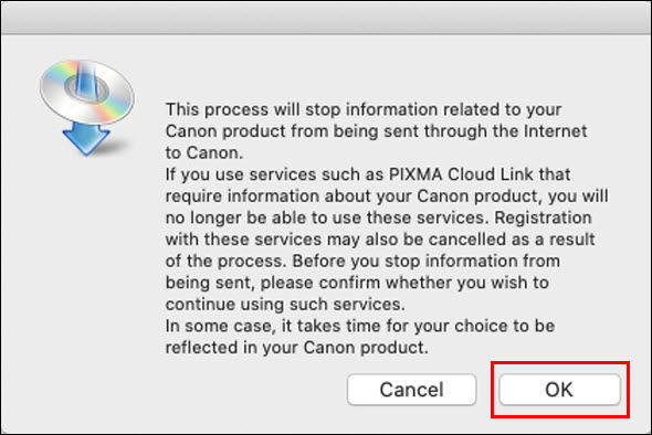

    If Do not agree was selected, the following information appears.  Click OK.
    If you clicked Do Not Agree, click OK (outlined in red) to continue

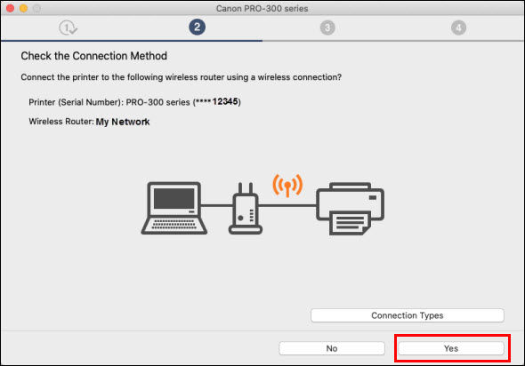

  7. Click Yes on the Connection Method screen.
    Click Yes (outlined in red) on the Check the Connection Method screen

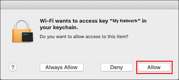

  8. Select Allow on the keychain message.
    Click Allow (outlined in red)

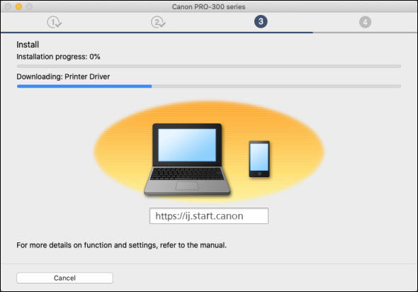

    The printer driver will be downloaded and installed. This may take several minutes depending on the speeds of your internet connection and computer.

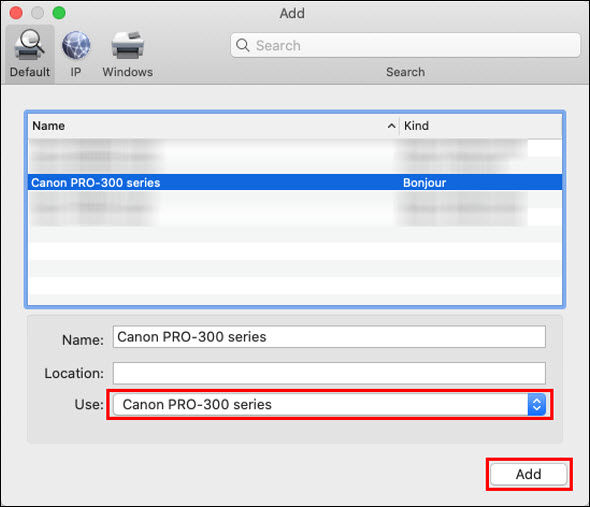

  11. Select your printer series with Bonjour listed in the Kind column. Then, select Canon PRO-300 series for Use: and click Add.
    Select the Canon PRO-300 series, then make sure that it's selected for Use: Click Add (outlined in red)

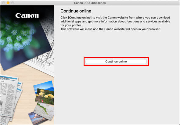

  14. If you wish to download and install any additional software,  click Continue online.
    Click Continue online (outlined in red)
