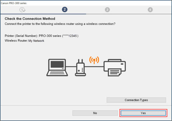

  4. Select Yes to connect the printer to your wireless router.
    Click Yes (outlined in red) on this screen

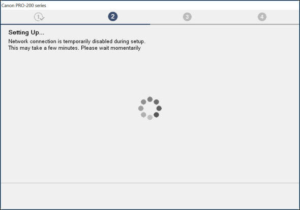

    The computer will temporarily disconnect from your wireless network.
    The computer will temporarily disconnect from your wireless network at this point

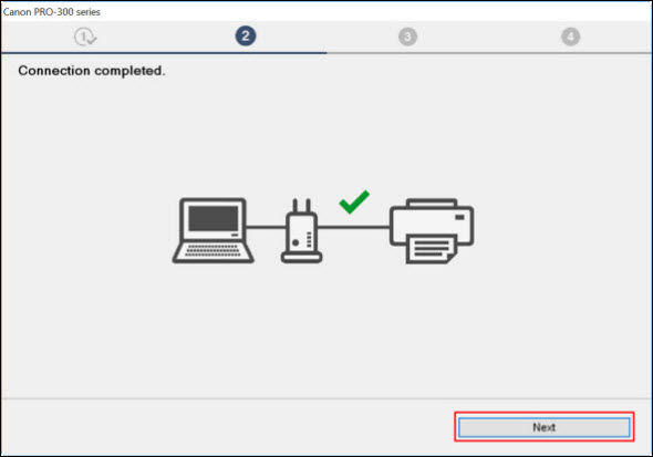

  5. Connection is completed, click Next.
    The connection is completed. Click Next (outlined in red)
     If your printer is not detected, you may need to either temporarily disable any firewall software, or you may need to configure that software to open blocked ports that the printer uses. Also, if you are using a dual-band router, further troubleshooting information can be found here.

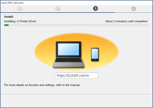

  6. The printer driver will be downloaded and installed. This may take several minutes depending on the speeds of your internet connection and your PC.

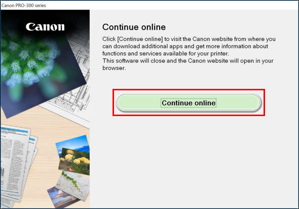

  8. If you wish to download and install any additional software,  click Continue online.
    Click Continue online (outlined in red) to go to the Canon website to download additional software for your printer if desired
