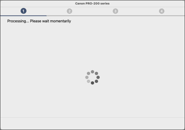

The installer will acquire information on the latest software for your printer. This may take a few moments.
Click Yes on the License Agreement. If you click No, the installer will not proceed.
Select Do not agree or Agree.
If Do not agree was selected, the following information appears. Click OK.
The installer will process for a few moments.
