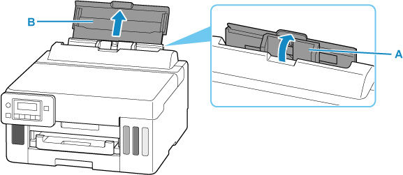

  2. Open the rear tray cover (A) and then pull up the paper support (B).

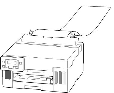

     Load long-length paper without pulling out the paper support. Depending on the weight of the paper, the leading edge may rise and printing may be shifted. Make sure that the leading edge of the paper doesn't rise, such as by holding the part that protrudes from the rear tray.

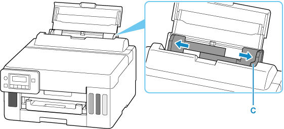

  3. Slide the right paper guide (C) to open both paper guides.

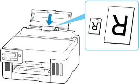

  4. Load the paper stack in portrait orientation WITH THE PRINT SIDE FACING UP.
    After loading the paper, the paper setting confirmation screen for the rear tray appears on the touch screen.
    Load the paper stack with the print side facing up

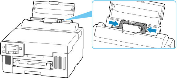

  5. Slide the right paper guide to align with both sides of the paper stack.
    Don't slide the paper guides too hard against the paper. The paper may not be fed properly.

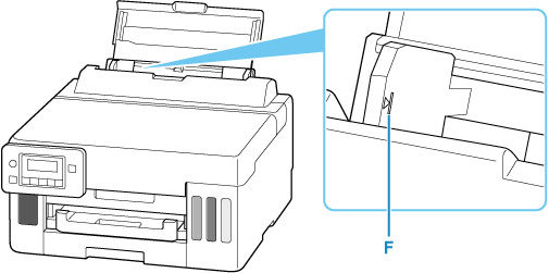

     Don't load sheets of paper higher than the load limit mark (F).

 When printing on long-length paper, support the output paper with your hands or use the printer in a place where the paper doesn't fall. If the paper falls, the printed side may become dirty or scratched. Also, when supporting the paper with hands, be sure not to pull the paper forcefully while printing.
