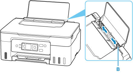

  3. Slide the right paper guide (B) to open both paper guides.

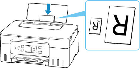

  4. Load the paper stack in portrait orientation WITH THE PRINT SIDE FACING UP.
    After loading the paper, the paper setting confirmation screen for the rear tray appears on the LCD.
    Load the paper in portrait orientation with the side you are going to print on facing up

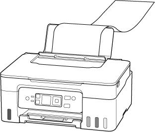

     Check that the tip of paper comes up against the inner part of a feed slot when you load long-length paper. Depending on the weight of the paper, the leading edge may rise and printing may be shifted. Make sure that the leading edge of the paper does not rise, such as by holding the part that protrudes from the rear tray.
    Hold long paper that protrudes from the rear tray to ensure that printing does not shift

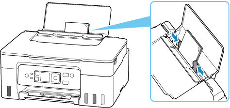

  5. Move the right paper guide and adjust the guides to both edges of the paper stack.
    Do not slide the paper guides too tightly against the paper. The paper may not be fed properly.
    Slide the right paper guide to adjust the guides against the edges of the paper stack

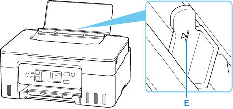

     Do not load sheets of paper higher than the load limit mark (E).
    Do not load sheets of paper beyond the load limit mark (E)

 When printing on long-length paper, support the output paper with your hands or use the printer in a place where the paper does not fall. If the paper falls, the printed side may become dirty or scratched. Also, when supporting the paper with hands, be sure not to pull the paper forcefully while printing.
