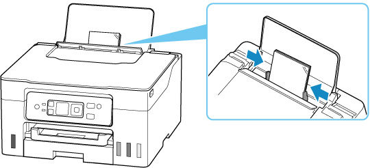

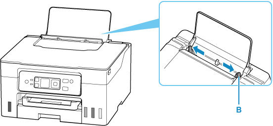

  3. Slide the right paper guide (C) to open both paper guides.
    Slide the right paper guide (B) to open both paper guides

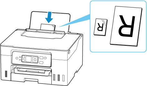

  4. Load the paper stack in portrait orientation WITH THE PRINT SIDE FACING UP.
    After loading the paper, the paper setting confirmation screen for the rear tray appears on the LCD.
    Load the paper stack in portrait orientation with the side to print on facing up
     Always load paper in portrait orientation (C). Loading paper in landscape orientation (D) can cause paper jams.
    Always load paper in portrait orientation (D), as loading paper in landscape orientation (E) can cause paper jams
     Check that the tip of paper comes up against the inner part of the feed slot when you load long-length paper. Depending on the weight of the paper, the leading edge may rise and printing may be shifted. Make sure that the leading edge of the paper does not rise, such as by holding the part that protrudes from the rear tray.
  5. Move the right paper guide and adjust the guides to both edges of the paper stack.
    Do not slide the paper guides too tightly against the paper. The paper may not be fed properly.

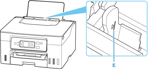

     Do not load sheets of paper higher than the load limit mark (E).
    Do not load sheets of paper beyond the load limit mark (F)

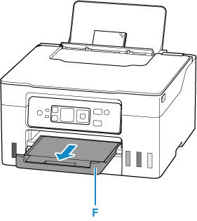

  7. Pull out the paper output tray (F).
    Open the paper output tray (G)
