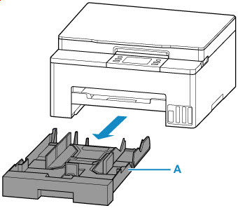

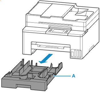

  2. Pull out the cassette (A) from the printer.
    Illustration showing the cassette being removed from the printer

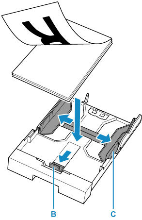

  3. Slide the paper guides (B) in the front and (C) on the right to open guides.
    Load the paper stack in portrait orientation WITH THE PRINT SIDE FACING DOWN, and place it in the center of the cassette.
    Load the paper stack in portrait orientation with the print side facing down
     Always load paper in portrait orientation (D). Loading paper in landscape orientation (E) can cause paper jams.

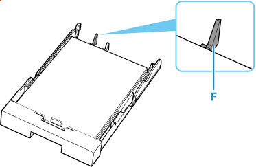

    Paper may not be fed into the printer correctly if it presses against the protrusion (F).

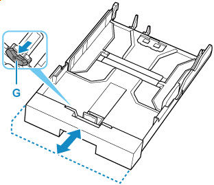

    To load legal-size paper in the cassette, pull the resizing tab (G) forward to extend the cassette. Condense the cassette while pulling the resizing tab (G) forward.
    Pull the resizing tab (G) forward to extend the cassette

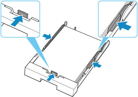

  4. Move the paper guide and adjust the guides to edge of the paper stack.
    Do not slide the paper guides too tightly against the paper. The paper may not be fed properly.

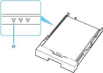

     Do not load sheets of paper higher than the load limit mark (H).

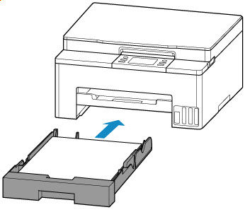

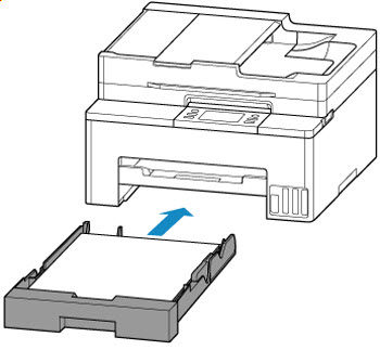

  5. Push the cassette into the printer until it stops.
    After inserting the cassette into the printer, the paper setting confirmation screen for the cassette appears on the touch screen.
     When paper larger than A4 is loaded, the cassette is extended and thus stops in a protruding position from the printer. Forcefully pushing it in may cause damage to the printer or the cassette.
