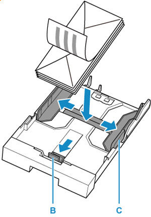

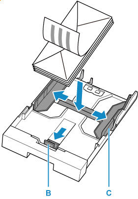

  3. Slide the paper guides (B) in the front and (C) on the right to open the guides.
    Load envelopes in portrait orientation WITH THE PRINT SIDE FACING DOWN, and place it in center of cassette.
    Up to 10 envelopes can be loaded at once.
    Load the envelopes in portrait orientation with the print side facing down
    Set the envelopes in portrait orientation with the address side down and the folded flap on the left.
    The envelopes should be set as shown

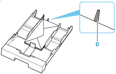

     Align paper with the line on the cassette to load.
    Paper may not be fed into the printer correctly if it presses against the protrusion (D).
    Paper may not be fed into the printer correctly if it presses against the protrusion (F)

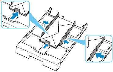

  4. Move the paper guide and adjust the guides to edge of the paper stack.
    Do not slide the paper guides too tightly against the paper. The paper may not be fed properly.

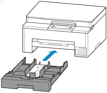

  5. Push the cassette into the printer until it stops.
    After inserting the cassette into the printer, the paper setting confirmation screen for the cassette appears on the touch screen.
