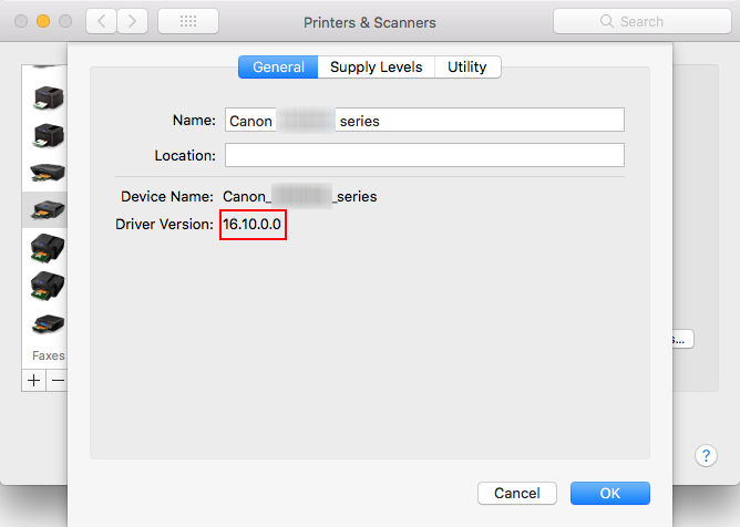

Additional steps (if you have an AirPrint driver)
Note If the Utility tab doesn't appear after you select Options & Supplies, you may use an AirPrint driver instead of a CUPS printer driver. In this case, you'll see Driver Version 2.0.
Driver Version: 2.0 displays on Printers & Scanners screen
If you use the CUPS printer driver, the version number will look similar to the one shown below:
Driver version: 16.10.0.0 displays on the Printers & Scanner screen
