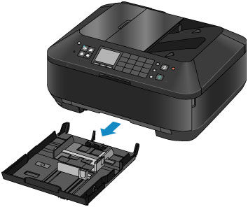

  3. Pull out the lower paper tray.
    figure showing lower paper tray sliding out

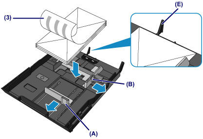

  4. Slide the paper guides (A) and (B) to open (see the image in step 3 below).
  5. Place the envelope stack in the center of the paper tray with print side facing down (3). The folded flap of the envelope will be facing up and on the left side.
    Figure shows front paper guide (A), side guides (B), envelopes print side down (3), not touching the tab (E)
  6. Align the stack with the edge of the tray, but don't let it touch the tab (E) (see image above).
  7. Align the front paper guide (A) with the envelope stack.

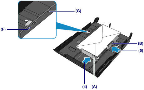

  8. Slide the side paper guides (B) to align with sides of the envelope stack.
    Note If the guides are too tight against the stack, the envelopes may not feed properly. Don't load envelopes higher than the load limit mark (max 10 envelopes) (F). Keep the stack height below the tabs (G) of the paper guides.
    Figure shows front and side paper guides (A) and (B), load limit mark (F), paper guides (G),

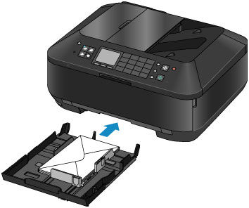

  9. Insert the lower paper tray into the printer, pushing it until it stops.
    shows lower paper tray being pushed back into machine

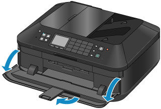

  10. Open the paper output tray by gently pulling on sides.
    figure showing the paper output tray open
