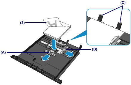

  3. Slide the paper guides (A) and (B) to open (see image in step 4 below).
  4. Place the paper stack in the center of the paper tray print side facing down.
    Note Align the paper stack with the edge of the tray, but it should not be touching the tabs (C).
    figure showing moving the guides so the stack of paper can be placed on it

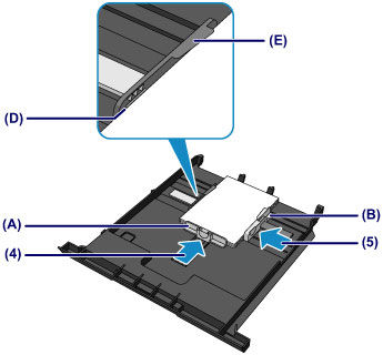

  5. Align the front paper guide (A) with the paper stack (see image in step 6 below).
    Note For standard sizes, the paper guide (A) should click into place.
  6. Slide the side paper guides (B) to align with sides of the paper stack.
    • If the guides are too tight against the paper it may not feed properly.
    • Don't load sheets of paper higher than the load limit mark (D).
    • Keep the paper stack height below the tabs (E) of the paper guides.
      figure showing the guides against the stack of paper in the tray

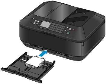

  7. Insert the upper paper tray into the printer, pushing it all the way in.
    figure showing putting the upper tray into the printer
