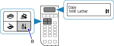

  1. Press the Setup button (B) on the printer.

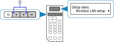

  2. Use the or button (C) to select Wireless LAN setup.
  3. Press the OK button.
