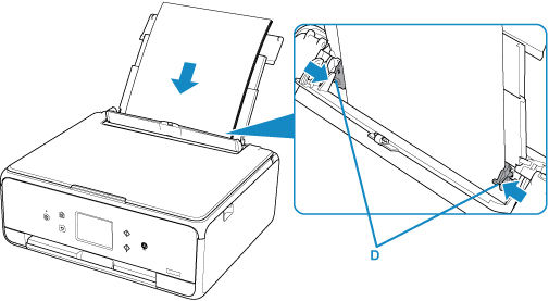

Slide the paper guides to open them, and load the paper in the center of the rear tray with the print side facing up. Load photo paper with the glossy side facing up.
Slide the paper guides (D) to align them with both sides of the paper stack. Be careful not to push the paper guides too hard against the paper.

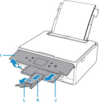

Open the operation panel (I), pull out the paper output tray (J) the paper output support (K), and the output tray extension (L).
Be sure to open the operation panel before printing. If the operation panel is closed, the printer won't start.
