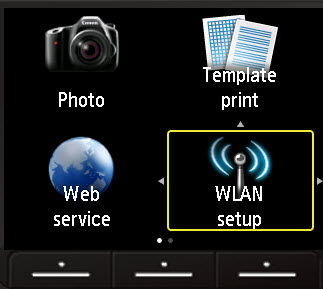

  1. Press the Menu button on the printer.
  2. Use the arrow keys located to the right of the display to highlight WLAN setup. Then, press OK.
    menu screen

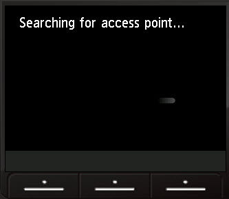

  3. The printer will begin to search for nearby networks.
    searching for access point screen

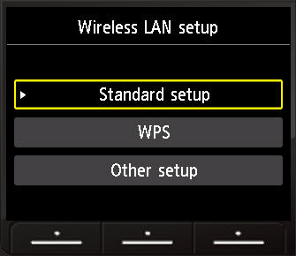

  4. When the following screen appears, Standard setup it highlighted by default.  Press OK.
    Wireless LAN setup screen
     If a WPS-enabled wireless router is nearby, a message will appear on the screen telling you to press the WPS button on the router, then the OK button on the printer.  If you don't want to connect to that WPS-enabled router, press the Stop button on the printer to bypass this message.

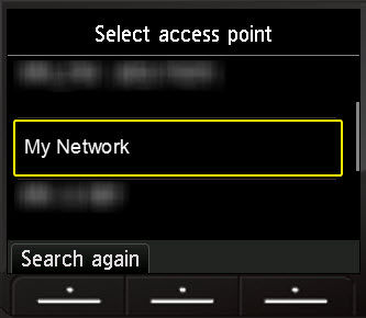

  5. The printer will search for nearby networks.  After it has finished searching, a list of nearby networks will appear on the screen.  Use the up and down arrow keys to select your network from the list.  Once you have highlighted your network, press OK.
    Select access point screen

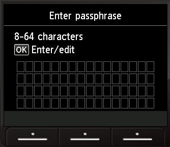

  6. If your wireless router has a password, the Enter passphrase screen will appear
  7. Press OK to proceed to the character entry screen.

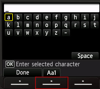

     By default, lower case letters will be on the screen.  If you need to switch to upper case letters or numbers and symbols, press the middle Function button below the screen.
  • Pressing the middle Function button (below Aa1) switches the character set to upper case letters.
  • Pressing the middle Function button a second time will change over to numbers and symbols.

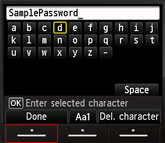

  1. After you enter the password, press the left Function button (under Done).
    Character entry screen with password completed and Done highlighted

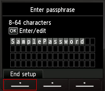

  2. You'll return to the Enter passphrase screen.  You'll see the password you entered on the screen.
    If you need to make any corrections to the password, press OK and you'll be able to make any corrections needed.
    If no corrections are needed, press the left Function key (under End setup).
    Enter passphrase screen with entered characters ready

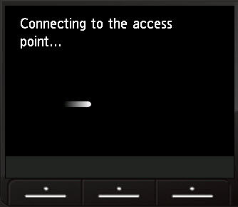

  3. The printer will attempt to connect to the network.
    Connecting to the access point... screen

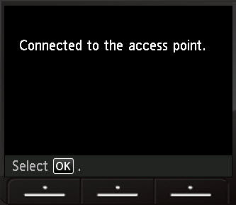

  4. When the printer connects to the network, press OK.
    Connected to the access point screen.

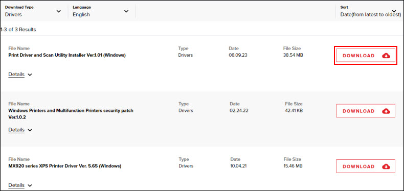

  2. Select Drivers from the Download Type drop-down menu. Then, select Download to the right of Print Driver and Scan Utility Installer Ver.1.01 (Windows).
    Click Download to the right of the Print Driver and Scan Utility Installer (outlined in red)
    If you're prompted to Run or Save the file, save it to your computer.

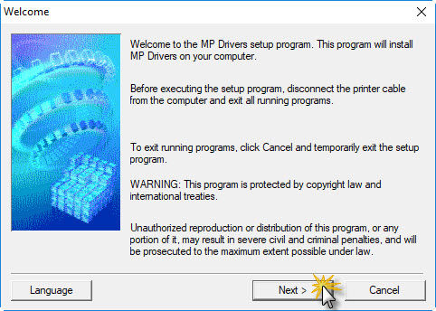

  4. When the driver installer begins, select Next.

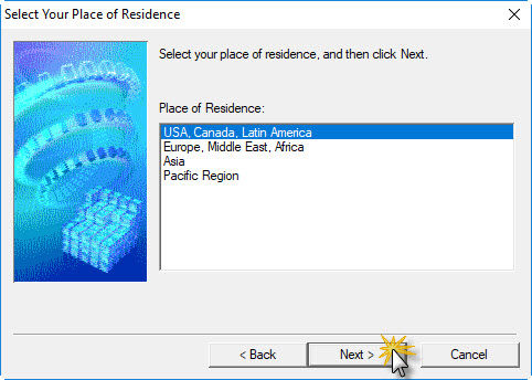

  5. Select your place of residence. Then, select Next.

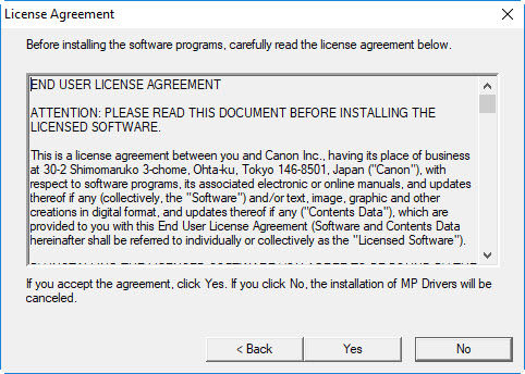

  6. Read through the License Agreement. Select Yes to continue. If you select No, the drivers will not be installed.
    The driver installation will start. This may take a few minutes.

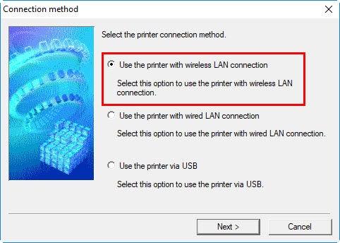

  7. When the Connection method window appears, select Use the printer with wireless LAN connection. Then, select Next.

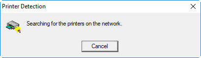

    The installer will search for the printer on the network. This may take a few minutes.

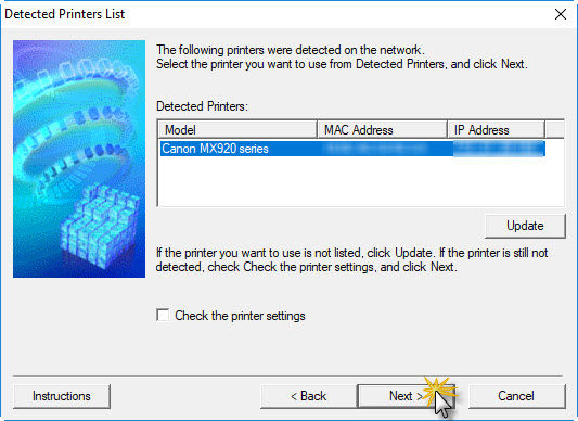

  8. The Detected Printers List window appears. Select your printer in the window. Then, select Next.
     If your printer isn't detected, select here.

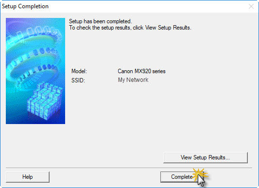

  9. The Setup Completion window appears.  Select Complete to close the installer.
You can now print and scan from your Windows PC.

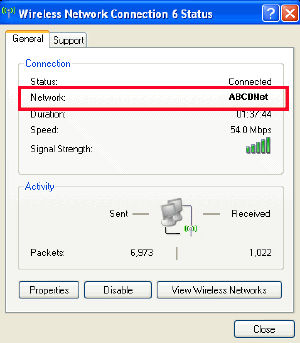

  1. Note the SSID name (Network name).
If you have WIndows XP, find the Network name here:
If you have WIndows Vista, find the Network name here:
If you have WIndows 7, find the Network name here:
If you have Windows 8 or 8.1, find the Network name here:
If you have Windows 10, find the Network name here:
If your PC isn't on the correct network, select your network and connect the PC to it.
