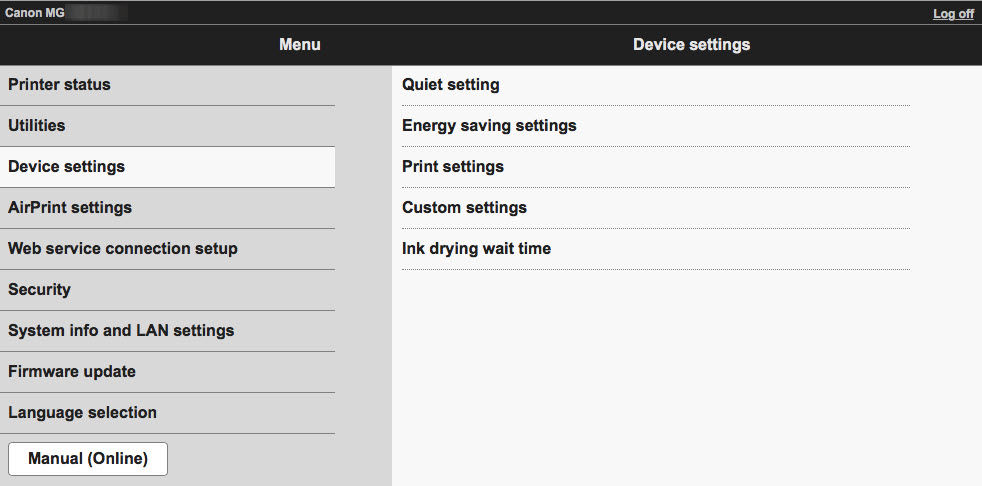

Device Settings
In this area, you will be able to toggle the Quiet setting, as well as adjust the Energy saving settingsPrint settingsCustom settings and Ink drying wait time.
For the Quiet setting:
Click or tap on Do not use quiet mode or Use quiet mode.  After the printer has processed the setting, click or tap OK.
For Print settings:
In this area, you can enable / disable Prevent paper abrasion.
For Prevent paper abrasion, place a check in the box to enable it or remove the check to disable it.  Then, click or tap OK.

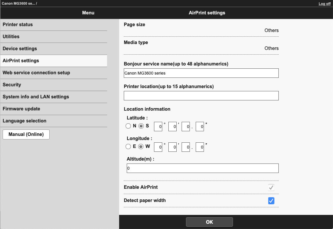

AirPrint Settings
In this area, you can specify the size and type of media you want to use with the printer.
You can also change the Bonjour service name, the printer location, and the latitude / longitude and altitude for the printer.
You can enable or disable AirPrint, and you can also enable or disable the Detect paper width function of the printer.

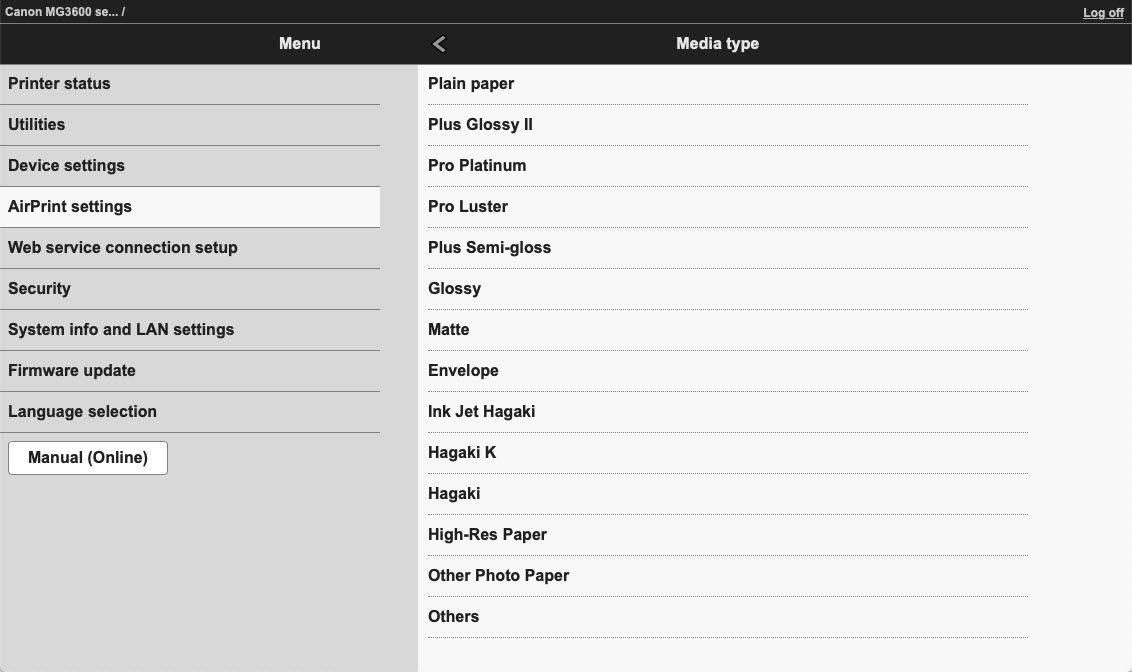

For the Page size and Media type:
Click or tap on Page size or Media type.
Then, specify the size or type of media desired.
Make any changes as desired.  Then, click OK.
