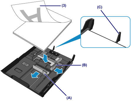

  3. Slide the paper guides (A) and (B) to open (see image in step 4 below).
  4. Place the paper stack in the center of the paper tray with the print side facing down (3).
    Image shows A and B paper guides, paper face down and tab C located on back of the tray
  5. Align the paper stack with the edge of the tray, but it should not be touching the tab (C) (see image in step 4 above).
  6. Align the front paper guide (A) with the paper stack.
    Note For standard sizes, the paper guide (A) should click into place.

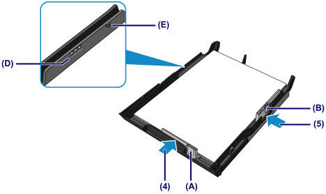

  • Slide the side paper guide (B) to align with the sides of the paper stack (see image in step 6 above).
    • If the guides are too tight against the paper, paper may not feed properly.
    • Do not load sheets of paper higher than the load limit mark (D).
    • Keep the paper stack height below the tabs (E) of the paper guides.

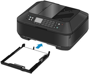

  • Insert the lower paper tray into the printer, pushing it until it stops.
    • Do not force the lower tray further into the printer.
