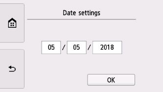

  7. Set date.
    1. Select a setting item to change.

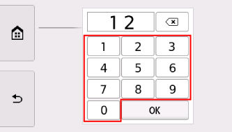

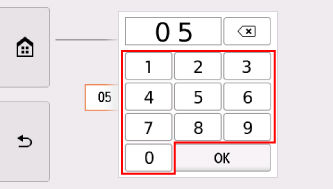

    2. Select number to enter.
      Enter only the last two digits of the year.
    3. Select OK.
    4. Select OK again when all settings are completed.

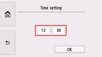

  8. Set time.
    2. Select a number to enter.
      Enter the date and time in 24-hour format.
    3. Select OK.

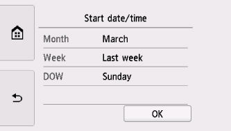

  8. Set date and time when summer time starts.
    1. Set date when summer time starts.
      Select a setting item to change, and then specify the setting. Select OK again when all settings are completed.

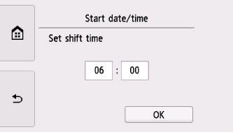

    2. Set time (in 24-hour format) when summer time starts.

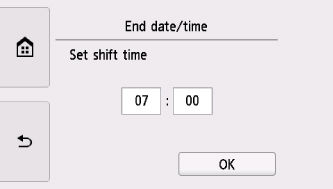

  9. Set date and time when summer time ends.
    1. Set date when summer time ends.

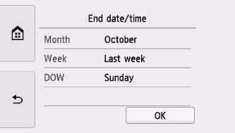

    2. Set time (in 24-hour format) when summer time ends.

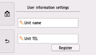

  7. Select User information settings.
    The screen to register the unit name and the unit fax/telephone number is displayed.

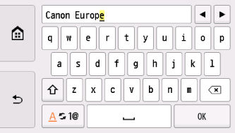

  8. Enter unit name.
    1. Select entry field under Unit name.
      The screen to enter the character is displayed.
    2. Enter the unit name.
    3. Select OK.
     Note

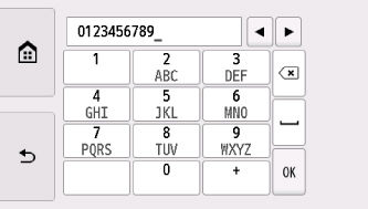

    1. Select entry field under Unit TEL.
      The screen to enter the number is displayed.
    2. Enter the unit fax/telephone number.
    3. Select OK.

  10. Select Register to finalize registration.
