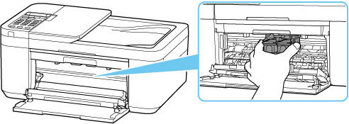

  4. Check if jammed paper is under the ink cartridge holder.
    If the jammed paper is under the ink cartridge holder, move the ink cartridge holder to the far right or left, whichever makes it easier to remove the paper.
    When moving the ink cartridge holder, hold the top of the ink cartridge holder and slide it slowly to the far right or left.

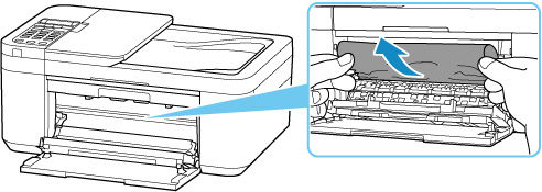

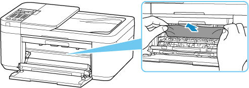

  5. Hold the jammed paper firmly with both hands.
    If the paper is rolled up, pull it out and grasp the edges of the paper.

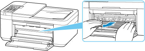

  6. Slowly pull out the jammed paper so as not to tear it.
