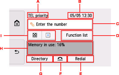

  3. Select FAX on the HOME screen.
    The Fax standby screen is displayed.
    1. Receive mode
      The receive mode selected currently is displayed.
    2. Date and time
      The date and time are displayed.
    3. Entry field of fax/telephone numbers
      Select to display the screen to enter the fax/telephone numbers.
    4. Function list
      You can use the each fax function and change the setting for the fax.
    5. Redial
      Select to send faxes with redialing.
    6. On hook dial
      Select to send faxes with the on hook dial function.
    7. Directory
      You can select a registered fax/telephone number.
    8. Current state
      The current state is displayed.

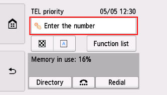

  4. Dial recipient's fax/telephone number.
    1. Select entry field of fax/telephone numbers.

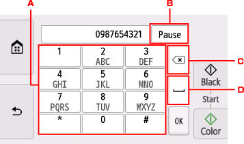

    2. Enter fax/telephone number.
      1. Numeric keys
        Enters the number.
      2. Pause
        Enters a pause "P".
      3. Delete
        Deletes the entered number.
      4. Blank space
        Enters a blank space.

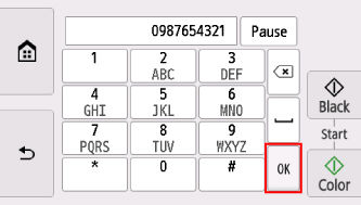

    3. Select OK.

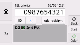

      The touch screen returns to the Fax standby screen.
  5. Press Color button for color transmission, or Black button for black & white transmission.
    The printer starts scanning the document.
