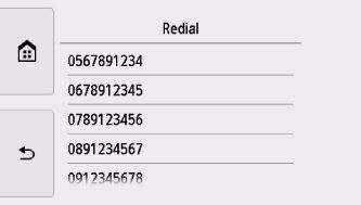

  5. Select Redial.
    The Redial screen is displayed.
  6. Select a recipient's number to redial.
  7. Press Color button for color transmission, or Black button for black & white transmission.

  • For manual redialing, the printer memorizes up to 10 recent recipients dialed by entering the fax/telephone numbers. Note that the printer does not memorize any recipients dialed using the redial function or selecting from the directory.
